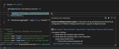

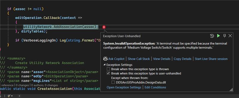

The Association class does not provide any way to set terminal configurations. I'm left with the following error: "A terminal must be specified becauset the terminal configuration of..."
Is there any known workaround that allows me to inject a JunctionJunctionConnectivity association into the Utility Network?
