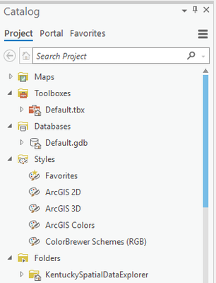

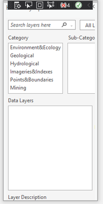

I generated a DockPane but some laptop users complained they are not able to see whole dockpane neither they can roll vertically to see the rest of the dockpane. There is a vertical scroll viewer shows up on catalog dockpane if content does not fit into it. I would like to utilize something like that.
On my dockpane I have list boxes mainly vs catalog pane has only tree view items but still there should be a way to do this
I tried a few things but I couldn't make it show up

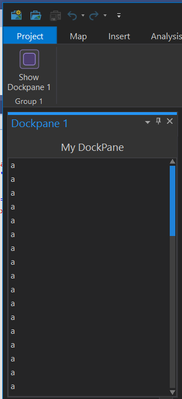

Sorry, that sample is not very easy to experience.
Attached is a project that looks like this when I run it:
tempStephenRhea_NV5
I think you're looking for the ScrollViewer XAML element.
<ScrollViewer VerticalScrollBarVisibility="Auto" HorizontalScrollBarVisibility="Auto">
  <ScrollViewer.Content>
    <StackPanel x:Name="MainStackPanel" Background="WhiteSmoke">
    </StackPanel>
  </ScrollViewer.Content>
</ScrollViewer>
tempStephenRhea_NV5
    </StackPanel>
</ScrollViewer>

Thank you for your answers. Both ScrollViewer and ListBox functon the same in terms of scrolling but ListBox changed the design a little bit, so I decided to use ScrollViewer. However, neither of them was scrolling if the controls fit inside in it. Furthermore, when DockPane floating scroll bar was not auto adjusting
So, I created an event which adjust the height of ScrollViewer when UserControl's size changed. Now, it works fine and adapts the height when dockpane size changes.
