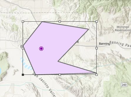

Sometimes to solve these kinds of things see if u can make the symbol first and then deconstruct it. Usually, if u cant make a symbol via the UI then the symbol probably can't be made via the api either (not always but in most cases).
So in the Pro help we have Position and place marker symbol layers .which contains an "At Center" placement for markers in polys.
A bit of fiddling with the symbology UI gives:
The last bit is deconstructing the symbol which involves a bit of trial and error. There are three symbol layers - the marker, a stroke, and a fill. The marker has a placement set to position it "At Center".
Note: I notice that Pro removes the stroke from the char marker to have it scale correctly when it is resized.

Final symbol:

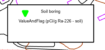

To summarize the code I have now:
var polygon = PolygonBuilder.CreatePolygon(listPoints, MapView.Active.Map.SpatialReference);
CIMTextSymbol sym = SymbolFactory.Instance.ConstructTextSymbol(ColorFactory.Instance.BlackRGB, 10, "Arial", "Regular");
(attaching text to the polygon)
GraphicElement polyTxtElm = LayoutElementFactory.Instance.CreatePolygonParagraphGraphicElement(newLayout, polygon, text, sym);
//create marker from the Font, char index,size,color
var cimMarker = SymbolFactory.Instance.ConstructMarker(213, "ESRI Geometric Symbols", "Regular", 25, ColorFactory.Instance.GreenRGB) as CIMCharacterMarker;
var polygonMarker = cimMarker.Symbol;
CIMGraphic polyTxtGra = polyTxtElm.GetGraphic();
var pointSymbol = SymbolFactory.Instance.ConstructPointSymbol(cimMarker);
MapPoint symPt = null;
Coordinate2D newCoord = new Coordinate2D(pX1, pY1+110);
symPt = MapPointBuilder.CreateMapPoint(newCoord);
var symPtGraphic = new CIMPointGraphic()
Symbol = pointSymbol.MakeSymbolReference(),
Location = symPt
symLayer.AddElement(polyTxtGra);
symLayer.AddElement(symPtGraphic);
That looks like this:
But of course, moving the polygon or the green element with the mouse does not bring them both together.
