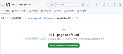

I need to work on a legacy version of  - specifically version 3.2 - however it seems to be missing - other older versions are working, but of course, the version I need is not.

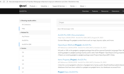

What do you want to do with references from GitHub?
You can use latest ArcGIS Pro SKD reference. Make search for your interest and then switch to version you want.

Well, yes fine, but should it really be missing in the first place, doesn't look great. Secondly - I'm trying to locate the correct version of the API for my custom instructions for use with CoPilot in Visual Studio - I didn't really feel comfortable with referenceing 3.6 API for AI based solutions/answers against a 3.2 version of Pro.

The References folder was added at 3.6 and doesn't exist in any of the previous versions. That folder contains a merge of the API documentation (XML in your Pro installation bin folder) and the Examples source code so using the examples directly should get you what you want/need.
If you use the master branch (a.k.a. latest), Copilot might on occasion provide suggestions for an API method/property/class added after release 3.2 and you will consequently get compile errors that have to be corrected manually.
