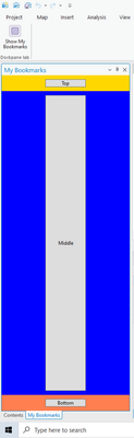

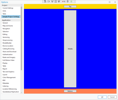

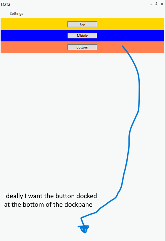

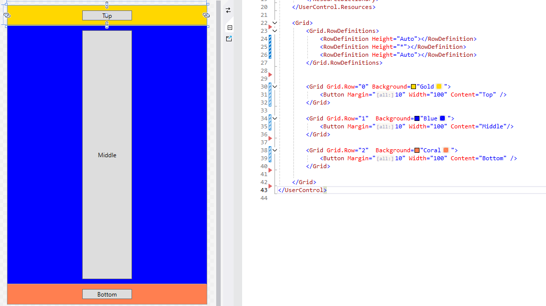

It works well - however if I want to make a button stick to the bottom (with a margin round it) and kind of have it separate itself away from all other controls on the dockpane - I find it almost impossible to figure out because you have to use a ContentPresenter - a kind of template dockpane and I think all the height sizing parameters go haywire!
Whats doubly annoying is that at design time - it looks fine but when you look at the actual control at run time it does not behave - can anyone suggest the correct XAML as I have lost hours on this and I can't waste anymore development time on this - see the screen shots:
Design Time:
Runtime:

Change Stackpanel to Grid:
        <Grid Grid.Row="1">
            <ContentPresenter  Content="{Binding CurrentPage}"></ContentPresenter>
        </Grid>
Stackpanel has some limitations
