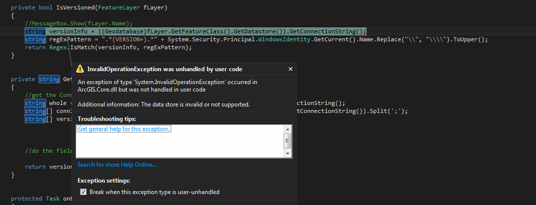

Hi,
I'm using the following line of code to get the ConnectionString info on a FeatureClass.  Usually there are no problems, but when I join a table to the layer, I get a "Data Store is invalid or not supported" error.  Any ideas as to why this might be happening??  The joined table is a .xls spreadsheet.

RichRuh
If I understand this correctly, the feature layer refers to a join between an excel file and another datastore, correct?  In this case, there is no actual datastore for the layer, since the join is computed in-memory.

RichRuh
Any join where the source tables come from different data stores takes place on the client, and the Datastore is invalid.
If you had access to the Join itself, you can get the origin and destination tables, but if you're coming directly from the layer the only thing you'll have is the JoinedTable.  I don't know of a way to go from the JoinedTable to the Join.
The only workaround I can suggest is to listen to events from SDE tables *and* joins (i.e., tables without a valid datastore).  This may mean listening to more events than you have to.
