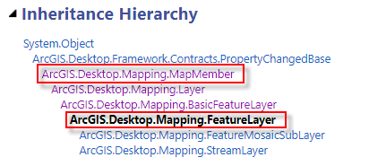

The selection is returned as a Dictionary of MapMembers and the list of selected object ids for each MapMember.  In order words: Dictionary<MapMamber, List<long>>.  Once you know the inheritance relationship between MapMember and FeatureLayer (in essence that FeatureLayer inherits from MapMember) - this is from the online help:
you can now search the Dictionary returned by GetSelection for the specific FeatureLayer (or MapMember) you are looking for.  Below is a button click sample looking to the number of selected records in the 'TestPoints' layer.
