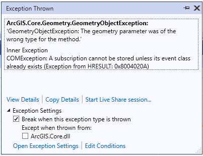

I used EllipticArcBuilder.CreateEllipticArcSegment() to create a segment, and passed the segment to  PolylineBuilder.CreatePolyline() function to generate a polyline. It gave me an error. But it worked when I use arcgis pro 2.8. It happens after I update my Arcgis pro to 2.9.3. Any suggest is appreciated.

@sjones_esriau Thanks for your reply.  I put my simple code below. Do I make anything wrong?
var arc2 = EllipticArcBuilder.CreateEllipticArcSegment(new Coordinate2D(-3924039.8966005351, 3789702.0418286407), -4.484, 6.280, 0, 16780, 1);
var poly2 = PolylineBuilder.CreatePolyline(arc2);
