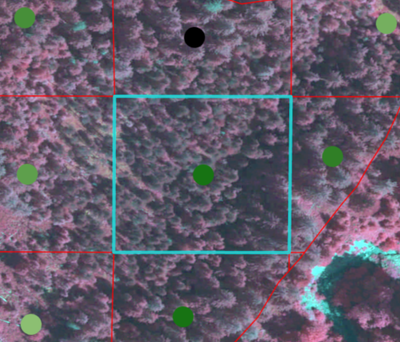

I would like to explain a bit in more detail what the stereo interpreter is doing. He is recording woody plant coverage in every square of a biotope object:
The workflow looks as follows:
  1. He selects a square on the stereo map
  2. In the code, the ObjectID of this square (polygon) is retrieved. The ObjectID corresponds to the ID of the point feature.
  3. The above function (GetFeatureAsync()) is called to get the corresponding point feature. The whereClause is "ID=" + objectID.
  4. After the error has occurred, ArcGIS Pro has to be restarted because the same errors occurs again and again when selecting a polygon.
I doublechecked, the objectID really exists when the error occurs. What could be the cause of the problem?
