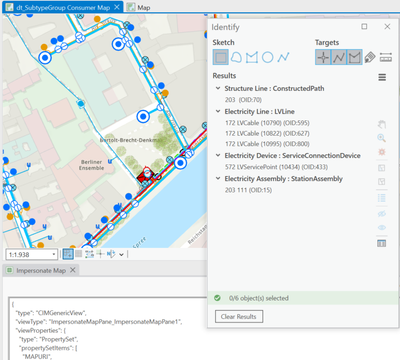

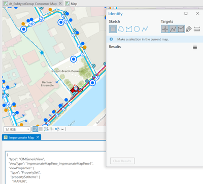

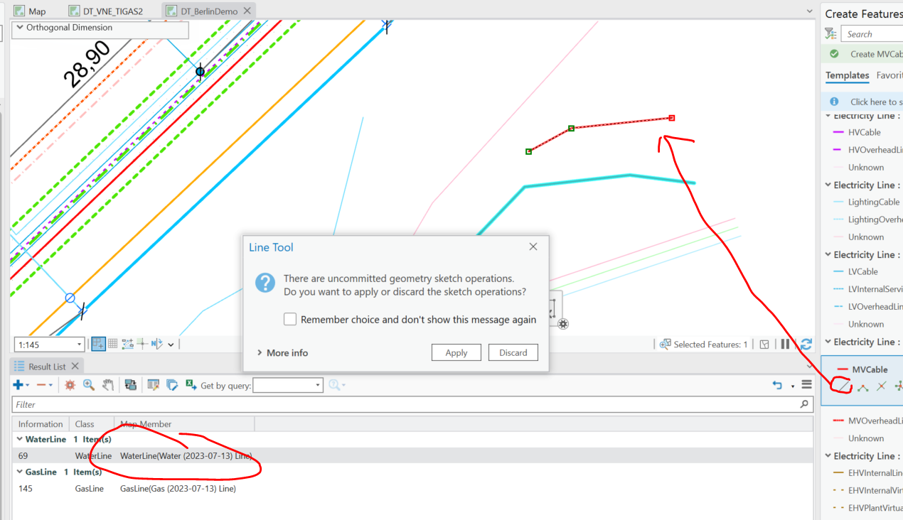

We have implemented a pane that derives from "TOCMapPaneProviderPane". Any tool is activated in the active map. E.g. "Create a line". As soon as the pane receives focus, the active tool is briefly deactivated and immediately reactivated. The currently active editing will be lost.
This is fatal and makes the pane unusable.

If you have a CustomTool active and set breakpoints on "OnToolActivateAsync, OnToolDeactivateAsync" and then activate the "Impersonate Map", you can observe the deactivation and activation.
