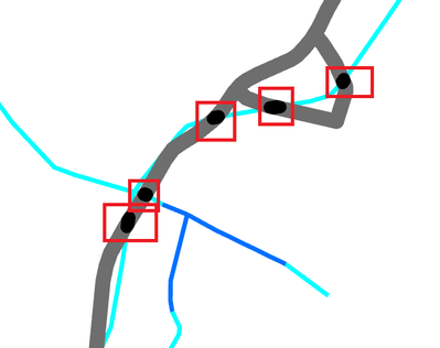

I have a question, I have two layers (polyline) from which I created a buffer of polygon layers and by intersecting them I created another layer with an intersection and now I would like to use the new layer to find the parts in one polyline layer and edit the verticals in them.
I hope I explained it clearly 🙂intersect.PNG I would like to edit the parts in red rectangles in that base layer. *Badly chosen place
But then you also say:
I assume you want to do the second, meaning you want to edit (what i assume is a road and a stream layer) either the street or road layer?   And you mentioned 'Verticals' does that mean you want to change the elevation (Y) of a 3D line feature class at the point of intersection?
DavidMrázek
The basic idea of ​​my problem is that I have the two initial layers (road and stream) but in some places these layers overlap, which makes no sense for the road to be on the stream (I don't mean the bridge). That's why I want to find places where they overlap more than just crossing and in those places move the stream a little to the side.
