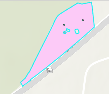

For example, a polygon like this:
Would anyone have an idea or advice on how to do this?
Is there any way to distinguish between the outer and inner polygon?

the outer ring should be the first part, the inner rings follow for singlepart shapes with holes
or an oft used method is to calculate the area for the bits using the "shoelace formula"... clockwise oriented outer rings yield a negative area and ccw inner rings yield a positive area

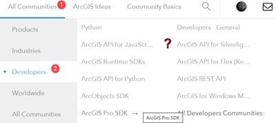

given the proliferation of curly braces, I moved it to the arcgis-api-for-javascript question section.
You choose your Community from the following to get a targeted location
moderators can do the moves

ArcGIS Pro SDK, c # language is not on the menu so it will be the best there
