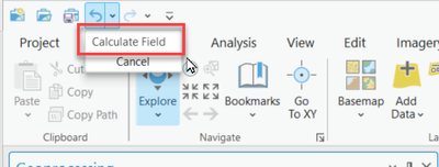

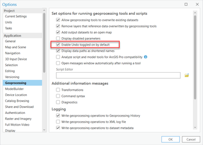

As I understand, the 'Field Calculator' run as a GP Tool.  So you can try this setting:
Or programmatically: SetEnableUndoOn Method—ArcGIS Pro
Either way seemed to work for me:
BrianBulla
Honored Contributor
Hi @Wolf .  Unfortunately, that made no difference for me.  With or without that "Enable Undo" checkbox checked, the Editor Extension will not fire when I use the Field Calculator tool.
