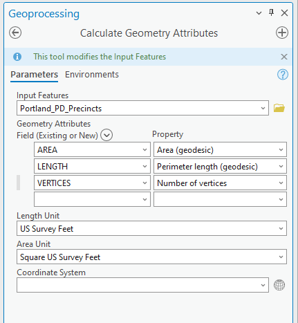

When faced with what syntax to use when running GP tools via ExecuteToolAsync I typically follow the same approach which u may find useful:
1. Open the GP Tool Dialog.
2. Manually configure the GP Tool Dialog with the desired options (may be some trial and error here)
3. Run the tool

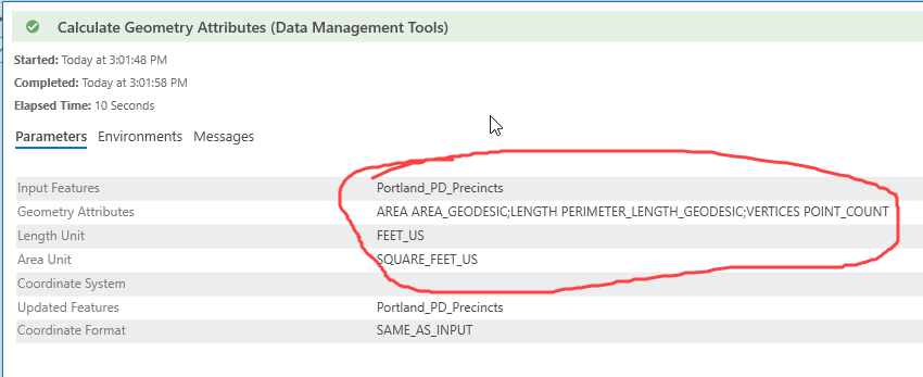

4. Click on "View Details", then "Parameters" to view the parameters the tool used based on my dialog options.
5. Transfer the options from the "View Details" parameters to the addin code. Typically, ";" (semi-colons) in the output params indicates an input list. Again, u may have a bit of fiddling here to get this right. However, every parameter that is shown on the View Details with an assigned value should have a corresponding parameter variable in your addin code.
For Calculate Geometry Attributes, this looks like:
1. Open the dialog and configure:
2. Run the tool, "View Details"...shows these parameter values based on my selections:
3. Transfer the parameters to the addin code:

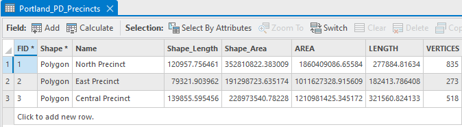

4. This gives the final output:
