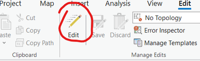

Is there any event we can listen for when the edit mode changes?

I meant event that is triggered when user interacts with EDIT button.
Main reason for asking it is, we are listening for changes in editing template, but when ESRI switches it, we don't know any more general event to listen to, to detect it.
