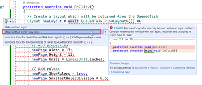

@JohnnyHarley12 , it looks like the instructions are missing an important step after you insert the layout construction code into the OnClick method.   You can let Visual Studio fix the problem for you by right clicking on the error and selecting "Quick Actions and Refactorings ..."
Or you can simply fix the OnClick method definition to this:
protected override async void OnClick()
We'll fix the issue for the next release.
