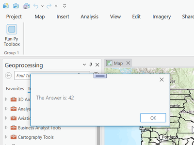

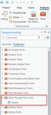

by Esri Regular Contributor
In addition to Charlie's answer there is also a arcpy toolbox sample available here:
arcgis-pro-sdk-community-samples/Geoprocessing at master · Esri/arcgis-pro-sdk-community-samples (gi...
This sample will add a toolbox with the py script to ArcGIS Pro:
I modified the sample and added a button that will call the py script in the toolbox from .NET:
I attached the sample solution.

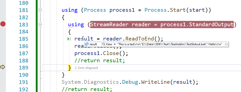

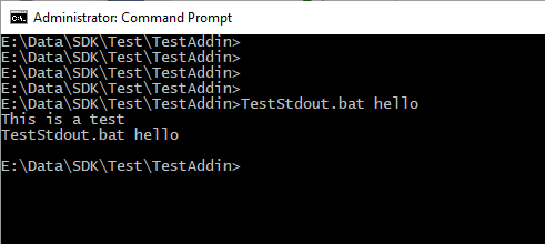

CharlesMacleod
I wasnt able to reproduce with a batch file - sorry not a python programmer. One thing I did do different was remove the QueuedTask but I dont think that is relevant.
FWIW, I did find a few other suggestions on solving issues reading stdout: here: https://stackoverflow.com/questions/1145969/processinfo-and-redirectstandardoutput
@echo OFF
ECHO This is a test
ECHO %0 %1
  string result = "";
  ProcessStartInfo start = new ProcessStartInfo();
  start.CreateNoWindow = true;
  start.FileName = @"E:\Data\SDK\Test\TestAddin\TestStdout.bat";
  start.Arguments = "Hello";
  start.UseShellExecute = false;
  start.RedirectStandardOutput = true;
  using (Process process1 = Process.Start(start)) {
    using (StreamReader reader = process1.StandardOutput) {
      result = reader.ReadToEnd();
      reader.Close();
      process1.Close();
      //return result;
  System.Diagnostics.Debug.WriteLine(result);
  //return result;
