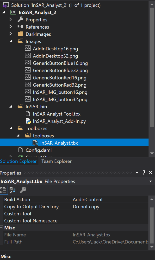

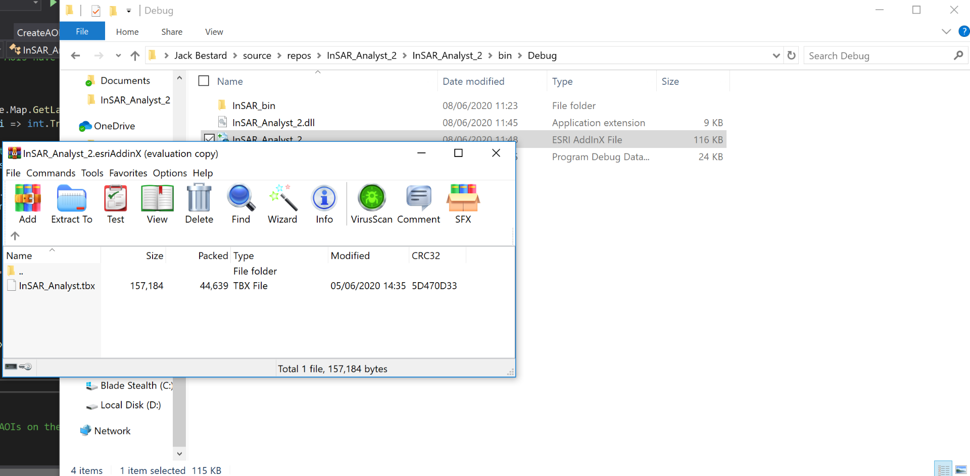

I have been building an ArcPro Add-In and I wanted to embed a toolbox so that when I send the add-in to the client I am able to source the path to the toolbox and then open it from a ribbon button. I followed the suggestions in this question but when I install the toolbox to ArcPro it doesn't create the toolbox folders within the AppData directory. When I check inside the add-inX file I can see the custom toolbox within there in the file structure shown in the previously asked question. I am wondering why when installing the Add-in does it not create the toolbox folder within appdata? I must be doing something wrong but I can't figure it out (I am fairly new to c# and add-in creation so that is probably where I am stumbling)
Any help would be appreciated and here are some images of the visual studio menu and the esri addinX file

The add-in must be loaded. (Step 10). The toolbox folder is not deployed on install.
When Pro shuts down the folder remains. _However_, if:
either - the add-in is uninstalled
or - the add-in is not loaded the next time Pro starts (eg security settings were changed)
the toolboxes folder will be deleted.....
So even though the folder may be present on the disk between Pro sessions, if the accompanying add-in is not loaded for the session then neither will its toolbox. This is mentioned under the "Note:" at the bottom of the previously referenced article.
I suspect the confusion is arising from examining the assembly cache location of a previously loaded add-in where the toolboxes folder would be present (if it had an embedded toolbox) and comparing it with the assembly cache location of an add-in with an embedded toolbox that has not (been loaded).
