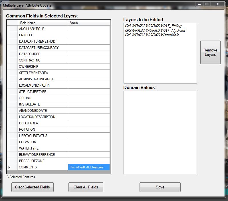

I have an EditOperation that runs on the _Click event of a form.  I'm pretty sure I have the ChainedEditOperation setup properly, as I have set this up previously in another tool I have made that work successfully.  This is my first time trying an EditOperation of a Form event.
What is happening is that edits are happening, but not showing up on the Undo Stack.  Does anyone know if there are issues with an EditOperation run on a Form event that may cause problems??  I have posted my code below, as well as the windows Form to help provide some context:
Basically it gives the user the ability to update common fields in the selected features of multiple feature classes, and the code below is for the Save button.

               for (int i = 0; i < gridFields.Rows.Count; i++)
                 if (gridFields.Rows.Cells[1].Value != null)
                   insp[gridFields.Rows.Cells[0].Value.ToString()] = gridFields.Rows.Cells[1].Value;
               if (isMainOperation)
                 // set up the edit
                 editOperation.Modify(inspector);
                 // execute it
                 bool result = editOperation.Execute();
                 // change the flag so we'll use the chainedOperation next
                 isMainOperation = false;
               else
                 // only create the chained operation once
                 if (chainedOp == null)
                   chainedOp = editOperation.CreateChainedOperation();
                 // queue up a modify
                 chainedOp.Modify(inspector);
          // finished the layer loop, lets commit anything in the chained operation
          if ((chainedOp != null) && !chainedOp.IsEmpty)
            bool chainedResult = chainedOp.Execute();
       });  //end of QueuedTask
    catch
    finally
       this.Cursor = Cursors.Default;
snippet two - illustrates the preferred EditOperation solution - queues all edits into a single EditOperation
private void btnSave_Click_NoChain(object sender, EventArgs e)
   try
       //Give the user a chance to get out.
      if (ArcGIS.Desktop.Framework.Dialogs.MessageBox.Show("Are you sure you want to update all the selected layers?", "Update Selected Features?", System.Windows.MessageBoxButton.YesNo) == System.Windows.MessageBoxResult.No)
        return;
       this.Cursor = Cursors.WaitCursor;
       QueuedTask.Run(() =>
          Map map = MapView.Active.Map;
          //Create the MAIN edit operation...this will show up on the Undo Stack
          var editOperation = new ArcGIS.Desktop.Editing.EditOperation();
          editOperation.Name = "Update Multiple Features";
          editOperation.EditOperationType = ArcGIS.Desktop.Editing.EditOperationType.Long;
          var inspector = new ArcGIS.Desktop.Editing.Attributes.Inspector(true);
          //Go through each layer in the Layers listbox
          foreach (string layer in lstLayers.Items)
            var currentLayer = map.FindLayers(layer).FirstOrDefault() as BasicFeatureLayer;
            var selection = currentLayer.GetSelection();
            IReadOnlyList<long> selectedOIDs = selection.GetObjectIDs();
            foreach (var oid in selectedOIDs)
              inspector.Clear();
              inspector.Load(currentLayer, oid);
          if (!editOperation.IsEmpty)
             if (!result)
               // throw an error message
   catch
   finally
snippet three - an optimized approach
private void btnSave_Click_NoChainOptimized(object sender, EventArgs e)
   try
          return;
           inspector.Clear();
           // load all the selected oids into the inspector
           // we can do this because each feature will have the exact same fields updated to the same values
           inspector.Load(currentLayer, selectedOIDs);
            // queue the modify
          // finished the layer loop - commit all the edits
            if (!result)
    catch
   finally
There's a lot of information here. Let me know if you still have questions about edit operations and chaining or if something I've said isn't clear.
Narelle
BrianBulla
Honored Contributor
Hi Narelle.  Wow!!  Thanks for taking the time to put all of that together.  That definitely helps to clarify how editing in ArcPro works.  I still need to sit down and work through making some changes to mine, but this will certainly help me optimize my code so it runs a bit smoother.
I'm really just a part-time coder, converting the code in a bunch of ArcMap tools so they work in ArcPro but I'm always up for making things work better than before.
I'll work on what you mentioned and post an further questions here.
Thanks!!
