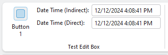

How can you push a string to the EditBox control from say a button control.  For instance, i would like to click on a button in the addin ribbon that would send a string to the EditBox text property.
CharlesMacleod
Here are two ways to do it. One uses an event which keeps the button and edit box loosely coupled, the other uses a direct reference where the button updates the edit box directly. The loosely coupled is the most flexible but is a bit more work than simply updating the edit box text - and, if that is literally all u need, then its overkill.
public class DateTimeStringChangedEventArgs : EventBase
  public string OldDateTimeString { get; private set; }
  public string NewDateTimeString { get; private set; }
  public DateTimeStringChangedEventArgs(string oldDateTimeString, string newDateTimeString)
    OldDateTimeString = oldDateTimeString;
    NewDateTimeString = newDateTimeString;
public class DateTimeStringChangedEvent :
  CompositePresentationEvent<DateTimeStringChangedEventArgs>
  public static SubscriptionToken Subscribe(
    Action<DateTimeStringChangedEventArgs> action, bool keepSubscriberReferenceAlive = false)
    return FrameworkApplication.EventAggregator.GetEvent<DateTimeStringChangedEvent>()
        .Register(action, keepSubscriberReferenceAlive);
  public static void Unsubscribe(Action<DateTimeStringChangedEventArgs> subscriber)
      .Unregister(subscriber);
  public static void Unsubscribe(SubscriptionToken token)
      .Unregister(token);
  internal static void Publish(DateTimeStringChangedEventArgs payload)
       .Broadcast(payload);
internal class Module1 : Module
  private static Module1 _this = null;
  private string _dateTimeString =
    DateTime.Now.ToString("G", CultureInfo.CurrentCulture);
  public string DateTimeString
    get
       return _dateTimeString;
    set
      var args = new DateTimeStringChangedEventArgs(
                       _dateTimeString, value);
      _dateTimeString = value;
      //Raise the event
      DateTimeStringChangedEvent.Publish(args);
  public EditBoxDirectApproach EditBoxDirectApproach { get; set; } = null;
internal class Button1 : Button
  protected override void OnClick()
    var date_string = DateTime.Now.ToString("G", CultureInfo.CurrentCulture);
    //Indirect, loose-coupling
    Module1.Current.DateTimeString = date_string;
    //Direct, direct-coupled
    Module1.Current.EditBoxDirectApproach.Text = date_string;
internal class EditBoxIndirectApproach : EditBox
  public EditBoxIndirectApproach()
    Initialize();
  private bool _ignoreEvents = false;
  private void Initialize()
    //This will invoke OnTextChange which is ok
    //as we havent subscribed to the event yet
    this.Text = Module1.Current.DateTimeString;
    DateTimeStringChangedEvent.Subscribe((args) =>
      _ignoreEvents = true;
      try
        //Invokes OnTextChange
        this.Text = args.NewDateTimeString;
      finally
  protected override void OnTextChange(string text)
    //prevent (infinite) recursion
    if (_ignoreEvents)
      return;
    Module1.Current.DateTimeString = text;
    base.OnTextChange(text);
internal class EditBoxDirectApproach : EditBox
  public EditBoxDirectApproach()
    Module1.Current.EditBoxDirectApproach = this;
    this.Text = DateTime.Now.ToString("G", CultureInfo.CurrentCulture);
