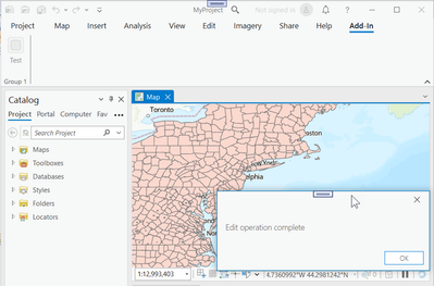

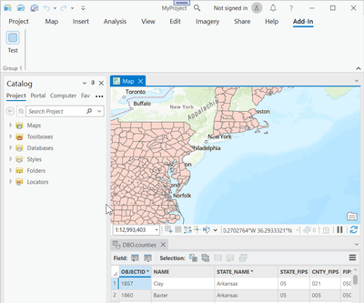

I tried your code snippet with a SQL Server Enterprise GDB and it works as expected.  Here are my modifications:
protected override void OnClick()
  if (MapView.Active == null)
    MessageBox.Show("No active map");
    return;
  QueuedTask.Run(() =>
    var featureLayer = MapView.Active.Map.GetLayersAsFlattenedList().OfType<FeatureLayer>().FirstOrDefault();
    if (featureLayer == null)
      MessageBox.Show("No Counties feature layer found");
      return;
    Table dnoXrefTable = featureLayer.GetTable();
    QueryFilter qf = new QueryFilter { WhereClause = $"STATE_NAME like ('New%')" };
    var deleteOperation = new EditOperation
      Name = "Delete features"
    using (var rowCursor = dnoXrefTable.Search(qf, false))
      while (rowCursor.MoveNext())
        using (var row = rowCursor.Current)
          deleteOperation.Delete(row);
    var delResult = deleteOperation.Execute();
    if (delResult != true)
      MessageBox.Show($@"Not successful: {deleteOperation.ErrorMessage}");
    MessageBox.Show("Edit operation complete");
I am using a copy of the Counties dataset (from the c:\data\admin folder using Community Samples data).  I coded my queryfilter to delete all counties where the state name contains 'New...'.
Here are my screen shots:
1. Before i click my delete button:
2. the delete function has completed:
3. After the OnClick exits (New York and New Hampshire are gone):

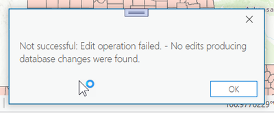

If i run the same delete function again i get this message:

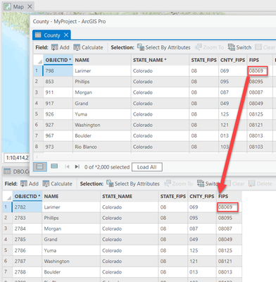

This code worked for me.  To test I have a feature class (County) and a table with related records (CountyTable).

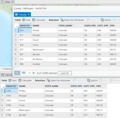

After i subscribe to the featureclass's row delete event, the related record is deleted after the feature is deleted.  This screen shot is after i deleted the 'Larimer' county:
I used the following code to accomplish this.  I think the issue is that you have to attach your delete (of the related row) to the 'parent edit operation'.
internal class ActivateRelatedDeletes : Button
  private SubscriptionToken _rowDeletedToken;
  private StandaloneTable _countyTable = null;
      return;
      _countyTable = MapView.Active.Map.GetStandaloneTablesAsFlattenedList().OfType<StandaloneTable>().Where(fl => fl.Name.Contains("CountyTable")).FirstOrDefault();
      if (_countyTable == null)
        MessageBox.Show("Cannot find County Table");
        return;
      var featureLayer = MapView.Active.Map.GetLayersAsFlattenedList().OfType<FeatureLayer>().Where(fl => fl.Name.Contains("County")).FirstOrDefault();
        MessageBox.Show("No County feature layer found");
        return;
      var addLinkedOperation = new EditOperation
        Name = "Add linked rows"
      _rowDeletedToken = RowDeletedEvent.Subscribe(OnRowEvent, featureLayer.GetTable());
  private void OnRowEvent(RowChangedEventArgs delEventArgs)
    // get the parent Edit operation
    var deleteEditOp = delEventArgs.Operation;
    // delete all related records using the FIPS relationship
    System.Diagnostics.Trace.WriteLine($@"Deleted related: {delEventArgs.Row["NAME"]}");
    var atts = new Dictionary<string, object>();
    QueryFilter qf = new QueryFilter { WhereClause = $"FIPS = '{delEventArgs.Row["FIPS"]}'" };
    using (var tableCursor = _countyTable.Search(qf))
      while (tableCursor.MoveNext())
        using (var tableRow = tableCursor.Current)
          deleteEditOp.Delete(tableRow);
