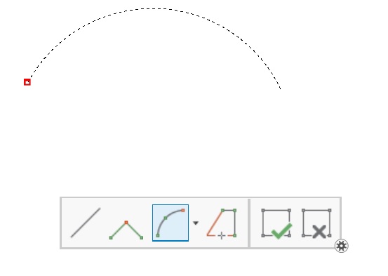

I have a problem with offset method. I create a polyline(I use arc segment like photo 1) with construction tool and I use offset methods like picture.

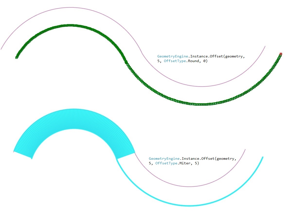

If I set offset type as round, there are a lot of vertex in offset line. (photo 2)
If I set offset type as miter, there are a lot of segments in offset line.(photo 2)

photo 1

Hi,
The output geometry is a linear approximation when the input geometry has curves, so that is why you see the extra vertices. However, the case you present with OffsetType.Miter shouldn't have those extra segments. This will be fixed in the next release.
