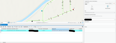

DanieleChiara
Hi Rich. Thanks for the fast reply.
Yes we are sure that the feature is a subnetwork controller (we pass directly the Global ID and the method)
the strange thing is that the save and discard buttons are enable but no dirty areas are created and no error was return in the whole process.
A screen on what i see in the PRO (Before and after the process)
the snippet of the code.
string  globalIdStringList = "'{597AD203-0637-4ABB-B628-6497D3CB74EA}'";
QueryFilter filter = new QueryFilter
WhereClause = $"GLOBALID IN ({globalIdStringList})"
filter.SubFields = "GLOBALID, OBJECTID";
using (var cur = deviceLayer.Search(filter))
ArcGIS.Core.Data.UtilityNetwork.Element element = null;
while (cur.MoveNext())
element = utilityNetwork.CreateElement(cur.Current);
utilityNetwork.GetSubnetworkManager().DisableControllerInEditOperation(element);
We miss something?
We try with pro 3.1.3 and 3.2.2 and enterprise 11.1
