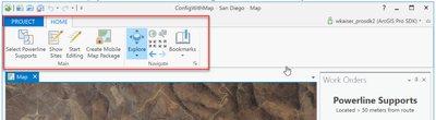

If you create a 'Manage Configuration' instead of an 'Add-in Module' you can customize the User Interface.  See details here:
ProGuide Configurations · Esri/arcgis-pro-sdk Wiki (github.com)
The ProGuide also references a sample that changes the user interface by removing most ribbons / buttons:
arcgis-pro-sdk-community-samples/Framework/ConfigWithMap at master · Esri/arcgis-pro-sdk-community-s...
and the sample's 'custom' UI looks like this:
An earlier version of the sample checked user permission to determine if the UI was read-only or read/write by controlling the DAML of the 'Start Editing' button, but for simplicity of the sample this feature was removed.
