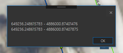

Those values are coming from a tool that looks at a selected feature water fitting feature and determines what subtype, diameter, etc. it needs to be based on the intersecting feature.  In the screen shot below, both of these water service lines were created using my MapTool.  The one on the left worked properly, snapping the 'plug' to the endpoint.  But in the one on the right, the 'plug' gets converted to a 'service point' because the code determines that it is not snapped to the to point.
The two coordinates above come from the code that is looking to make sure the to-point and feature point are the same.  I just created a message box to try and figure out what was going wrong.
MessageBox.Show(toPoint.X.ToString() + " - " + toPoint.Y.ToString() + "\n" + fittingPoint.X.ToString() + " - " + fittingPoint.Y.ToString());

Sorry about the delay, Brian, but I just now got around to revisit your issue.   Let me first summarize what i think the workflow and the resulting problems are:
  • A MapTool is used to sketch a line.
  • The sketched line geometry is used to create two points: a 'Connection' point which is the 'from' point of the line (first point) and a 'Plug' point, which is the 'to' point of the line (last point).  The points are computed as shown here:
  • MapPoint connectionPoint = ((Multipart)geometry).Points[0];
  • MapPoint plugPoint = ((Multipart)geometry).Points[((Multipart)geometry).PointCount - 1];
  • A new fitting feature is created using the plugPoint (let's call this one fitting) using the plugPoint's geometry by calling: plugPoint.Clone().  The fitting's attributes are also driven by the 'Connection' point, which should be connected to a water man.
The first problem is that the coordinates of plugPoint are changed as a result of calling 'Clone' and hence your fitting's point location is not coincident with plugPoint.  Is that still the case as stated in your original question above?
The second problem is that the fitting turns into a service point type because the Connection point is not connected to the water main?
I also wanted to know what projection your data is using.  Is it the same projection as is used by your sample map?  NAD_1983_UTM_Zone_17N?
I wrote a test program to duplicate the Clone problem and i was not able to duplicate the problem.   For the second issue i would first look at the snapping configuration in your MapTool.  Make sure the tool is configured to snap to the correct layer(s) ... i think we have discussed this in another thread: https://community.esri.com/thread/258729-help-with-finding-intersecting-layer
