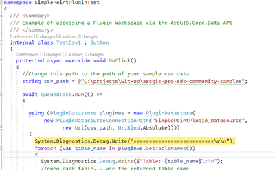

OK I decided to find a sample and test with that.
I went to git hub and found the Simple Point Plugin - https://github.com/Esri/arcgis-pro-sdk-community-samples/tree/master/Plugin/SimplePointPluginTest
I downloaded the files and only changed the path to the sample.
I ran it in Visual Studio 2022 and put a breakpoint at line 57 in TestCSV1.cs
I then added a watch variable for MapView.Active.Map.GetSelection()
Exactly the same issue. So, I at least know it is not just my code showing this issue. But no further ahead.
