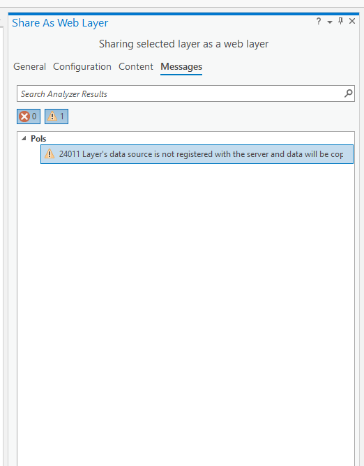

Hi,
I would like to create UI that rembles other UI elements in ArcGIS Pro.
I've looked at the style guide https://github.com/Esri/arcgis-pro-sdk/wiki/proguide-style-guide but cannot find the infomation that helps me with this challenge.

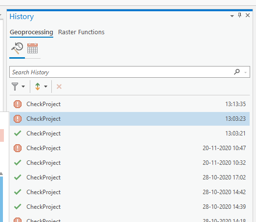

I am creating at DockPanel that calls a GP-tool. I would like to display the results from this tool in the Dockpanel a'la Messages in Share a Web Layer or like the History view.
I would like to reuse controls and standard images where it is possible.
If this can be done, is there someone who can point me in the right direction 🙂
Robert
