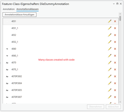

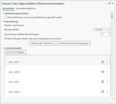

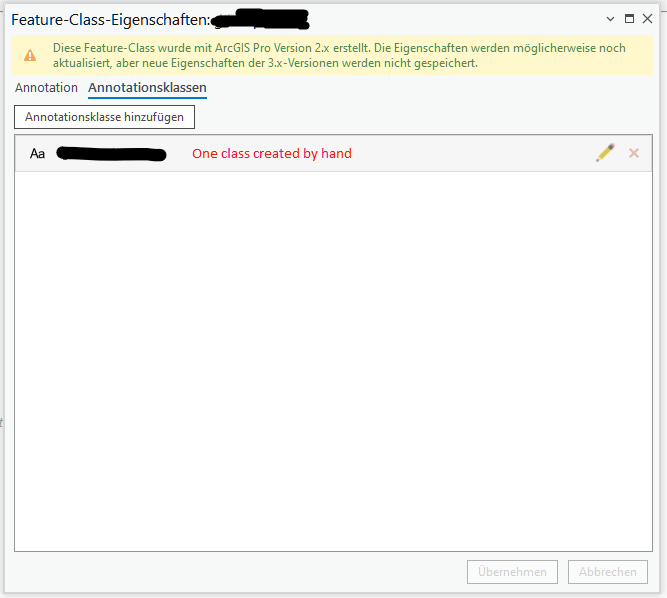

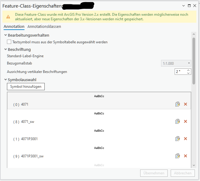

Hi, I am trying to genereate AnnotationFeaturesClass with the code example provided in ProSnippets .
What I am trying to achieve is to recreate an CIMLabelClass we created by hand. What we ended up with, when creating by hand, is one CIMLabelClass that holds all Labels (following two images).
The one CIMLabelClass
and all the Labels

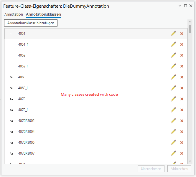

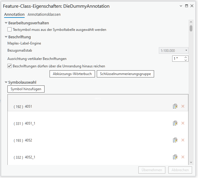

However, when I use the provided example code for each Label one CIMLabelClass is created (next images).
Individual CIMLabelClasses
for every Label
How do I create one CIMLabelClass via code to hold all Labels?

Multiple symbols/labels are not currently supported in SDK.
Support for multiple symbol/label identifiers and annotation class(es) in an annotation feature class will be added in future releases.
Aashis
by Esri Contributor
Meroni
Thank you for the reply. Any information on when this will be added to the SDK?
Aashis
by Esri Contributor
It should be in Pro SDK 3.1 release, planned for Q1 2023
