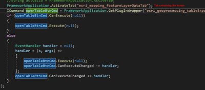

pspada_WT
Hi,
I've found the solution. You need to activate the TAB where that command is present. For some reason at first click it doesn't work so i create an eventhandler which is activated only in the case the button is in not execute state. This eventhandler is fired when the buttton state change from "not can execute" to "can execute".

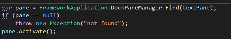

pspada_WT
Hi,
I found the daml ID of the contenten pane (I've found in the DAML ID reference under Dockpane)
"esri_core_contentsDockPane"
I still cannot execute the ICommand. What I'm missing?

pspada_WT
Hi,
