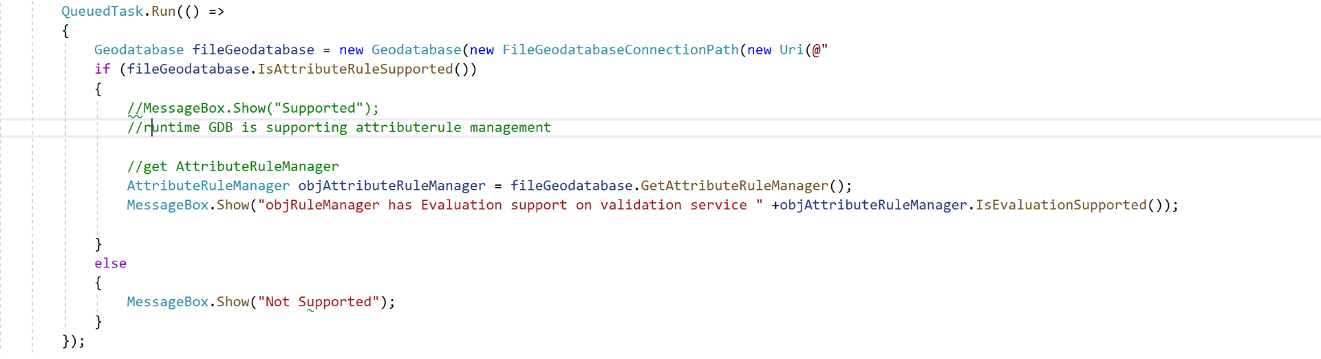

Hi All,
    I want to create attribute rules through programmetically.
For this, Read the filegeodatabase and checked whether AttributeRule supported or not.
               Created AttributeRuleManager
But, here we don't have option/method to create attribute rules.
ProConcepts Geodatabase · Esri/arcgis-pro-sdk Wiki · GitHub
Can you please help me here. Thanks in advance.
Regards,
Sreeni.

Hi Sreeni,
The geodatabase API doesn't allow schema changes (DDL).
To programmatically add attribute rules, you will have to either
  • Write a Python script
  • Execute geoprocessing tools using the geoprocessing API
Here is an overview of the attribute rules toolset.
I hope this helps,
--Rich
