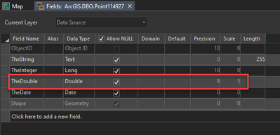

I stand corrected.  The Geodatabase team pointed out the error in my test add-in where I chose a scale larger than the precision.  Once I fixed that error I get the proper result:
I used the following code snippet to create the feature class.  The 'selectedFeatureLayer' is a feature layer I get from the TOC in order to get my database connection.
var selectedLayerTable = selectedFeatureLayer.GetTable();
var testName = $@"Point{DateTime.Now:HHmmss}";
var hasZ = false;
var hasM = false;
// Create a ShapeDescription object
var shapeDescription = new ShapeDescription(GeometryType.Point, SpatialReferences.WebMercator)
	HasM = hasM,
	HasZ = hasZ
var objectIDFieldDescription = new ArcGIS.Core.Data.DDL.FieldDescription("ObjectID", FieldType.OID);
var stringFieldDescription = new ArcGIS.Core.Data.DDL.FieldDescription("TheString", FieldType.String);
var intFieldDescription = new ArcGIS.Core.Data.DDL.FieldDescription("TheInteger", FieldType.Integer);
var dblFieldDescription = new ArcGIS.Core.Data.DDL.FieldDescription("TheDouble", FieldType.Double)
	Precision = 9,
	Scale = 5
var dateFieldDescription = new ArcGIS.Core.Data.DDL.FieldDescription("TheDate", FieldType.Date);
using (var geoDb = selectedLayerTable.GetDatastore() as Geodatabase)
	var fcName = $@"{testName}";
	try
		// Assemble a list of all of our field descriptions
		var fieldDescriptions = new List<ArcGIS.Core.Data.DDL.FieldDescription>() {
						objectIDFieldDescription,
						stringFieldDescription,
						intFieldDescription,
						dblFieldDescription,
		// Create a FeatureClassDescription object to describe the feature class to create
		var fcDescription =
			new FeatureClassDescription(fcName, fieldDescriptions, shapeDescription);
		// Create a SchemaBuilder object
		SchemaBuilder schemaBuilder = new SchemaBuilder(geoDb);
		// Add the creation of the Cities feature class to our list of DDL tasks
		schemaBuilder.Create(fcDescription);
		// Execute the DDL
		bool success = schemaBuilder.Build();
	catch (Exception ex)
		MessageBox.Show($@"Exception: {ex}");
