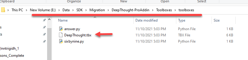

Here is a Pro SDK sample: https://github.com/Esri/arcgis-pro-sdk-community-samples/tree/master/Geoprocessing/DeepThought
It contains a python toolbox: "DeepThought.tbx". It has a tool "answer.py" with a toolname "Answer"
and so:

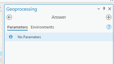

internal class ShowGPDialogButton : Button {
  protected override void OnClick()
    var tool_path =
     @"E:\Data\SDK\Migration\DeepThought-ProAddin\Toolboxes\toolboxes\DeepThought.tbx";
    var tool_name = System.IO.Path.Combine(tool_path, "Answer");
    //map just so happens to be of Portland
    var wkid = MapView.Active.Map.SpatialReference.Wkid;
    var env_array = Geoprocessing.MakeEnvironmentArray(outputCoordinateSystem: $"{wkid}");
    Geoprocessing.OpenToolDialog(tool_name, null, env_array);
results in:

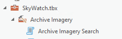

ManalSiddiqui
So as I suspected, the subfolder was the problem. I am only able to launch the tool if it is directly in the toolbox, however being in a subfolder within the toolbox makes it crash. Would you know the cause of this?
Kristofer-Sentry
I am having the same issue. Calling OpenToolDialog with a path to a script within a toolset results in the same error as @ManalSiddiqui : "Tool has failed to open: Error HRESULT E_FAIL has been returned from a call to a COM component.". Moving the script to the top level of the toolbox fixes the issue, but that is a impractical solution for a toolbox that is neatly organized with dozens of tools.
