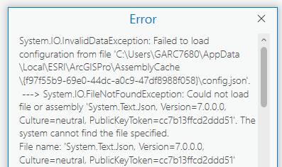

I am having the exact same problem with System.Text.Json. Same error message and PublicKeyToken. It also happened after updating an AddIn from 2.8 to 3.1. We confirmed the dependency is installed and in the AddIn AssemblyCache. No problems during build time, the error message only pops up after opening Pro.
We think it is caused by the assembly being a dependency of another one, rather than being called directly. This is preventing it from being packaged with the AddIn dll. Could this be the case? Is there a way to specify hidden dependencies in the .csproj file?
