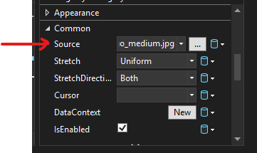

So working on our company Addin off and on. I've added some Button and DockPane controls and have used custom images with BuildAction=Content. It all works great.
I've extended the functionality with a Pane and ProWindow control but could not get any images to display. It dawned on me that maybe I was doing something wrong. From the forum I found a post that said use BuildAction=Resource. So I did that and it worked!!!
So my question is...what is the difference? Why do we need two options? Why wouldn't the control auto detect that a BuildAction on the graphic is not compatible? What if I need the same graphic in various controls that use Content and Resource? Do I have to add it twice?
