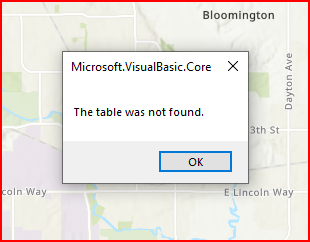

I think I've gotten close to getting this working but the function to read in the table stored in the .txt file can not read the table. I am probably using the wrong method, I'm using a FileSystemDatastore.OpenDataset(Of Table)(...).

 I do use " (QF.WhereClause = "LayerName = '" & Value & "'") " later but for now I'm just trying to figure out why the table is not being read.

Hi,
Seeing you're reading just a .txt file - I would recommend using standard .NET read/write classes/methods to open your file rather than the FileSystemConnectionPath object.
https://learn.microsoft.com/en-us/dotnet/visual-basic/developing-apps/programming/drives-directories...
This link has a code snippet which seems to suit your situation -  opening a text file and reading lines.
Thanks
Narelle
