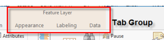

Greetings,
We are starting to create a series of tools for Pro.    We want to build these tools separately, but have them appear in the same tab / ribbon having the company name.  Is this possible?    Experimentation seems to produce a ribbon with the same name multiple times.
Or would we have to do something different, such as tab groups.
Thank you
