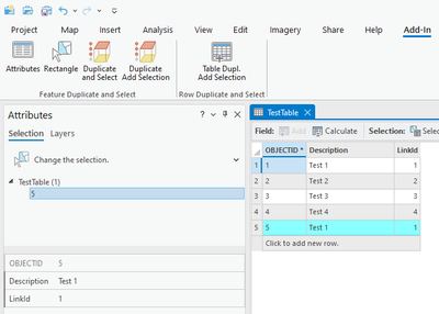

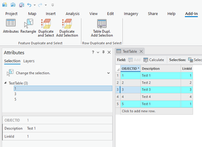

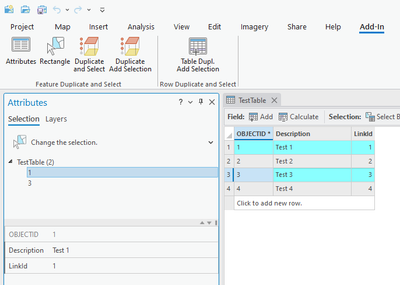

Let's say there are two rows in your target FeatureClass (or StandAloneTable) selected like in the example below (OID 1 and 3 are selected):
Now comes your edit operation and creates one new row.  From here there are multiple options, which one do you try to implement?
1) the new row (OID 5) is added to the existing selection:
2) the new row (OID 5) becomes the only selected row in the selection:
