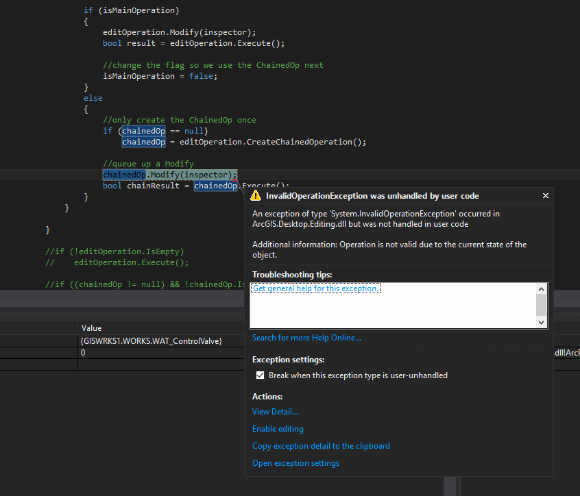

Does rejectedCount++ ever get hit? I cant see where the else block lines up.

Yes, I have tried adding a chainedOp.Execute right after the Modify, but then the code crashes.  Without it, I just get the same value plugged into each feature as you mentioned.

The error message isnt that helpful. It could be complaining about the inspector object. Instead of Inspector.Clear in the loop try creating a new one there and use that before the load.

oh and as was just pointed out to me, you need to create the chained op each time in the loop. Take out the null check.
I missed that.

Great!  Thanks for the help.  The Inspector.Clear didn't really make any difference, but creating the chainedOp each time through the loop is what made the difference.
I'd previously used a ChainedOp when I was trying to add a group of edits as one item on the Undo stack.  Doing what is apparantly the 'wrong way' worked in that case because I was not dependent on the results of previous edits for the next edit.  But when you do need that previous edit for the next, it looks like creating the chainedOp each time is essential.
