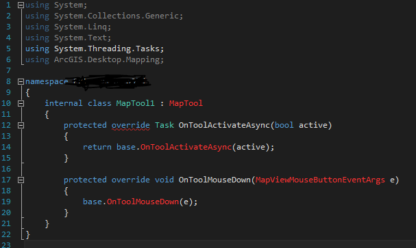

Hi,
We're unable to add a maptool control to our Add-In project. We have the latest version of Pro and the SDK installed (we uninstalled beta version properly).
In our visual studio project we goto Add > New Item > ArcGIS > ArcGIS Pro Map Tool and this creates the class for us.
But the MapTool class cannot be found in ArcGIS.Desktop.Mapping namespace:
Cannot resolve symbol 'MapTool'
The dll reference is correctly inlcuded in project, and imported with using statement as above.
If I use the assembly explorer and look  in ArcGIS.Desktop.Mapping, there is no MapTool class. But it is listed in the API page here:
http://pro.arcgis.com/en/pro-app/sdk/api-reference/topic9155.html
What's going on here? We have tried to reinstall ArcGIS Pro and the SDK, but did not fix the issue.
Other control types (e.g. button, dockpane) work fine.
Can somebody help?

p.s. I tried adding a maptool to a NEW arcgis pro module project and it worked. So I guess there is an issue with our current project. Any ideas?
by Anonymous User
Not applicable
Ok nevermind - I fixed it. I was missing ArcGIS.Desktop.Extensions reference from the project.
