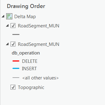

In my application I have two gdb_s with two layers with the same name on the same Map.
(Don't ask me why: this is how the client wants and my project manager has enforced the specs.
Previously I have put them on separate MapViews and synchronized the views...)
I diferenciate the two layers by the presence of the db_operation field, and edit accordingly their symbology:
To a certain point, I have to check the second layer and add additional fields.

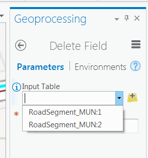

Also related:
It is a pain into *** to have same layer names!
The related Add or Deleting-Field Geoprocessing tools have a way to differentiate layers with same names:
However the Content does not use this technique, and neither the Attribute Table(s):
(I still differentiate them by the presence of the db_operation field, but it is the 90th column in the above grid!)

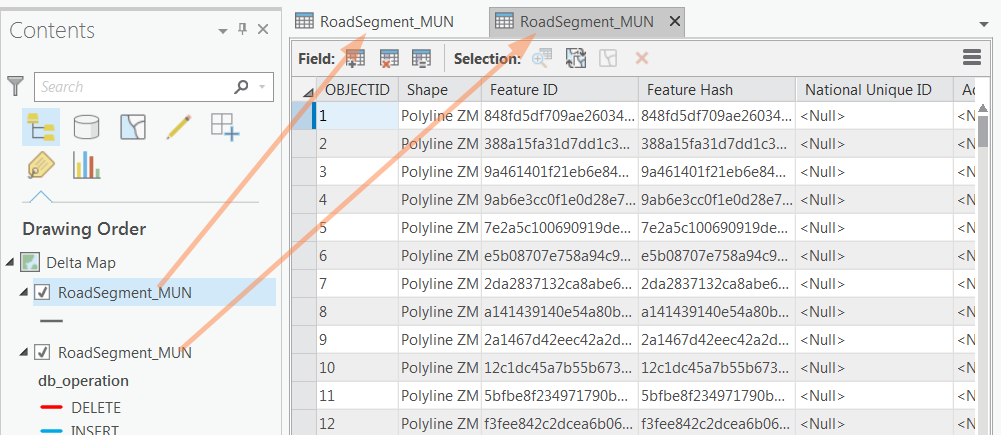

HoriaTudosie
It happens also when trying to delete directly from the attribute tables:
then:

However, for now, I want to point out that my first comment has nothing to do with coding:
I have placed the two gdbs aside in the content on the same mapView. Then from each of them I have right click and selected Attribute Table.
Selected the second one, right-click on the header of a field which exists in both of them and selected Delete.
The field in the table which I have right-clicked remains, however the one in the table/layer which appears first in the content has been deleted.
(I have just tried again and it reproduces!)
That was done without code, using just the UI of ArcGis Pro 1.3!
This behavior reproduces what happens in my code...
