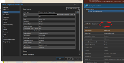

I have created an add-in with an AttributeTabEmbeddableControl, following the instructions at ProConcepts Editing · Esri/arcgis-pro-sdk Wiki · GitHub. The control works as expected on a file geodatabase source (First image) but doesn't work when the layer source is a feature service (Second Image). I have only tested in Pro 3.3.1. Is this expected behavior or is it possible I'm doing something wrong. I have attached the project

The ActivationExtension pattern only works with geodatabase datasets and feature services. For feature services this pattern is currently limited to feature services published referencing geodatabase datasets and is not working for Hosted feature services in Enterprise and Online

BUG-000175139 was logged as an issue related to ArcGIS Online feature services and following the AddActivationExtension pattern for custom behavior. This pattern is already supported for feature services published by reference to Enterprise.
ENH-000173660 is to support the ActivationExtension pattern with AGOL based feature services, this has not been implemented yet. I would consider reaching out to Support to get your account attached to this enhancement to help prioritize it if you feel this applies to you.
