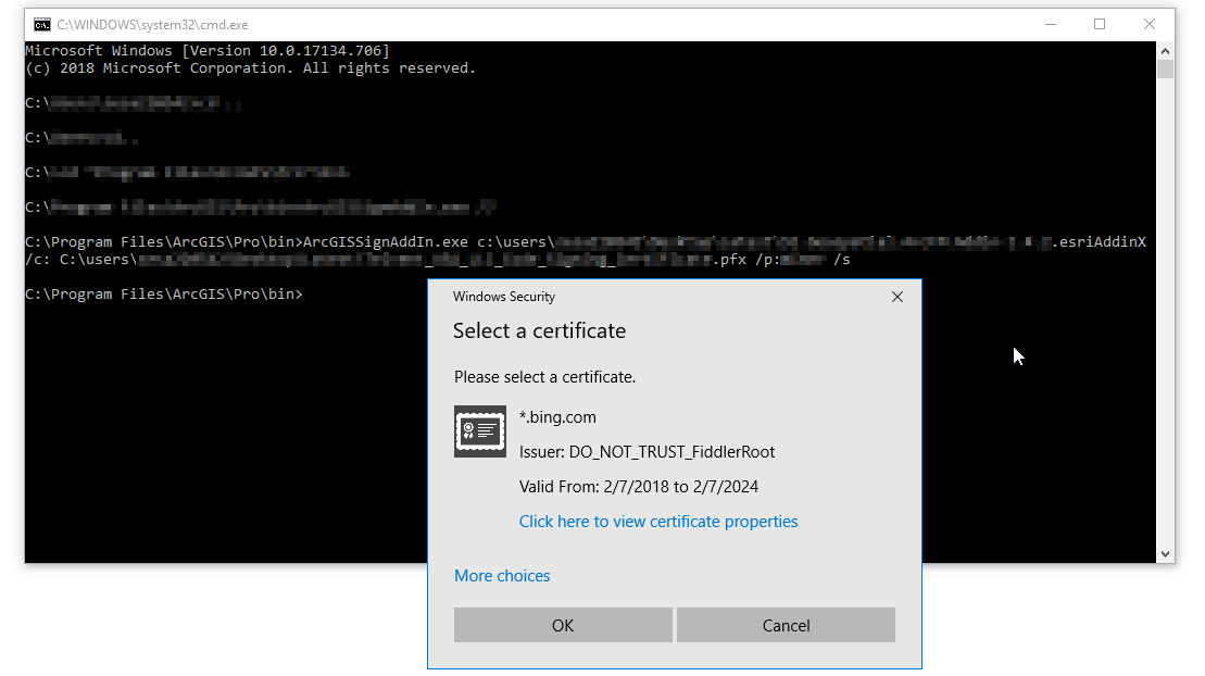

Thanks Uma, I should note, when I run same command on my development desktop, I get a dialog like this presented, which is also new behavior that I hadn't seen before, is this dialog expected? I specified a pfx and password in my commandline and specified /s which I'd have assumed would run everything silently. Nothing with the pfx or cmd-line parameters has changed on our end recently.

FredericPoliart_EsriAU
Have you managed to resolve this issue?
It looks like Fiddler is running.

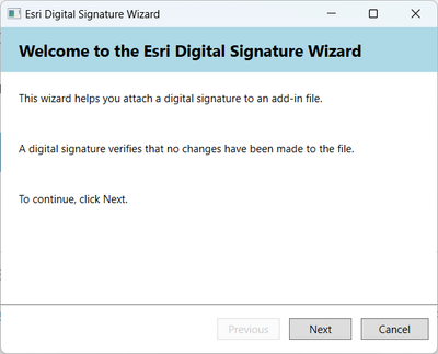

ljlopez
If you copy the code available at https://github.com/esri/arcgis-pro-sdk/wiki/ProGuide-Digitally-signed-add-ins-and-configurations as is, then you get the dialog below. In order to fix it, the new line in the Exec tag needs to be removed so that the command is defined in one single line.
