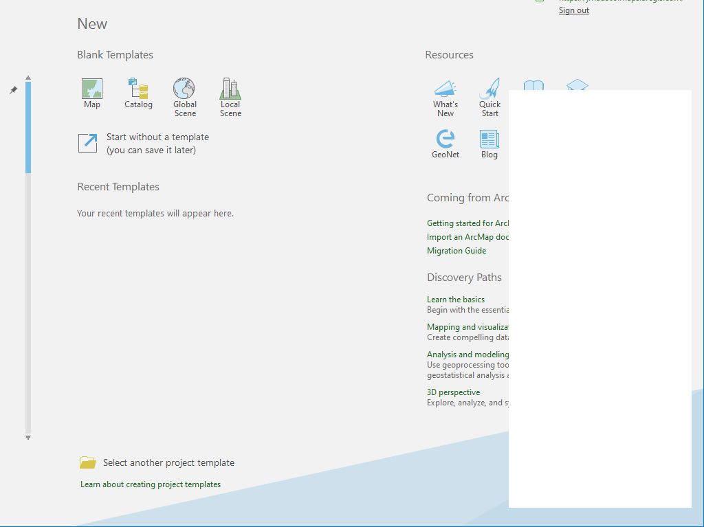

I'm using the latest software version ArcGIS Pro 2.7.3.  My startup page has a white rectangular silhouette that covers part of the page.  This also happens when I program a custom start page.  It sort of looks like the same size as one of my panes that is docked to the right of the screen.  Any idea how I debug this and get that removed?
Its quite obvious, I don't think I need to circle it:

 I tried this using Pro 2.7.3 and I can't duplicate your issue, however, I had a similar issue with Outlook about a month back where I saw a similar 'silhouette'  across the top of my outlook window.  After I updated my OS and video drivers the problem went away.

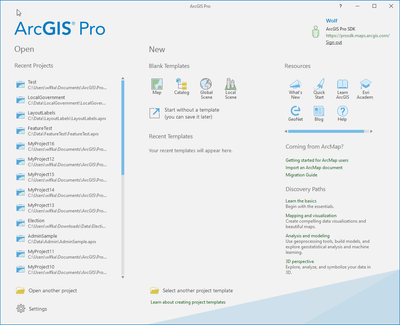

Here's my startup screen:

Thanks for the tip.  I'll check my drivers although one of my colleagues is seeing the same thing.  If I remove all my add-ins, it goes away.  If I reinstall my add-in that I have been developing, I see it again.

@Wolf With your hint I nailed it down to one of my panes in my Add-in.  I have a webbrowser control inside my pane.  If I remove it, the the white rectangle goes away.  I'm using it so I can print html status messages to a console like window (my pane).  Maybe ArcGIS doesn't support webbrowser control inside pane in this way?  I'll have to think of an alternative way to display html if I can't fix.
