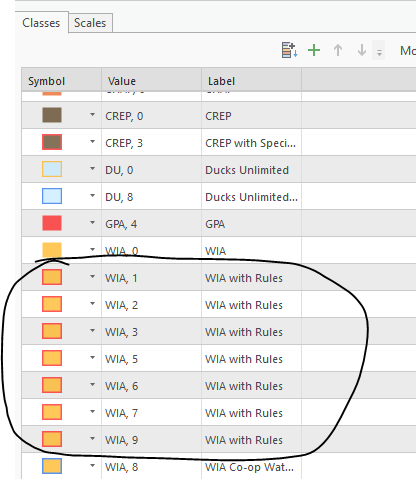

Hello,
I'm using the ArcGIS Pro SDK to modify the symbology for some of our layers. Everything is going good except one thing is evading me. I have a feature layer that utilizes unique values. I have managed to symbolize my layer to match the screenshot below. The last thing i need to to figure out is how I can group the symbols to be under one symbol instead of 7 different ones. I want to take the 'WIA with Rules' and group them into one symbol. Anyone have any ideas on how to do this?
I'm assuming it has something to do with the CIMUniqueValues FieldValues or with the CIMUniqueValueGroup, but i cant figure it out.
Thanks!

Hi Nikholai,
To group the values using the API, you can do this.
1. Create your Unique Value renderer the way you have been doing.
2. To add "grouping" you have to work with the CIM (Cartographic Information Model).
   * Get the Layer's definition as CIMFeatureLayer.
   * Access the Renderer from the definition.
   * Modify the "Groups" property on the Renderer.
Below is the code snippet I used on a layer. It had two fields that I symbolized on. I then grouped the features with the "Rock" attributes.
        //Get the Layer's CIM Defintion
        var lyrDefn = featureLayer.GetDefinition() as CIMFeatureLayer;
        //Access the renderer
        var renderer = lyrDefn.Renderer as CIMUniqueValueRenderer;
        var symbol1 = SymbolFactory.Instance.ConstructPointSymbol(ColorFactory.Instance.RedRGB);
        var symbol2 = SymbolFactory.Instance.ConstructPointSymbol(ColorFactory.Instance.GreenRGB);
        //Create the info needed for the Grouping
        var groupRiverValues = new List<CIMUniqueValue>
          new CIMUniqueValue { FieldValues = new string[] {"River", "5"} }
        var groupRockValues = new List<CIMUniqueValue>
          new CIMUniqueValue { FieldValues = new string[] {"Rock", "2"} },
          new CIMUniqueValue { FieldValues = new string[] {"Rock", "3"} },
        //This is the part where you create the grouping classes
        var uniqueValueClasses = new List<CIMUniqueValueClass>
          new CIMUniqueValueClass{Symbol = symbol1.MakeSymbolReference() , Editable = false, Patch = PatchShape.Default,Label = "River,5", Values = groupRiverValues.ToArray(), Visible = true},
          new CIMUniqueValueClass() { Symbol = symbol2.MakeSymbolReference(), Editable = true, Patch = PatchShape.Default, Label = "Rock,3; Rock,4",Values = groupRockValues.ToArray(), Visible = true}
        //Create the "Groups"
        var groups = new List<CIMUniqueValueGroup>
          new CIMUniqueValueGroup {Classes = uniqueValueClasses.ToArray(), Heading = "DisplayField,SubDisplay" }
        //Set the Groups property on the renderer object
        renderer.Groups = groups.ToArray();
        //Important: Set the modified layer definition back
        featureLayer.SetDefinition(lyrDefn);
Let me know if you run into issues.
Thanks
Uma
