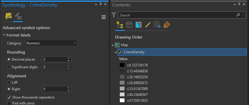

Hi Guys,
Would like to check how to set number format in CIMRasterClassifyColorizer object.
Below is the code I am using and it does not seem to be working. Uma Harano‌?
  CIMRasterClassifyColorizer newColorizer = await this.SelectedRasterLayer.CreateColorizerAsync(classifyColorizerDef) as CIMRasterClassifyColorizer;
            var numberFormat = new CIMNumericFormat();
            numberFormat.RoundingOption = esriRoundingOptionEnum.esriRoundNumberOfDecimals;
            numberFormat.RoundingValue = this.DecimalPlaces; //int 1 or above
            newColorizer.NumberFormat = numberFormat;
this.SelectedRasterLayer.SetColorizer(newColorizer);
When I check in Advance symbol option, it seems to be effective. but the labelling does not follow at all.

Hi Than
The code I provided is for 2.6.
In 2.5, when you make changes to the Number format of a renderer/colorizer using the API, it does not get updated in the TOC. This is a known issue in the 2.5 version of the Pro API. There is no fix for this in 2.5. I just checked out the code snippet you provided above - it is using an Internal class. It is recommended to not use Internal namespaces.
We have now fixed this in the 2.6 API using the new static class you can see in my code snippet.
