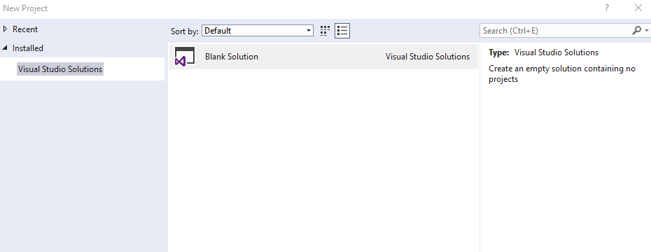

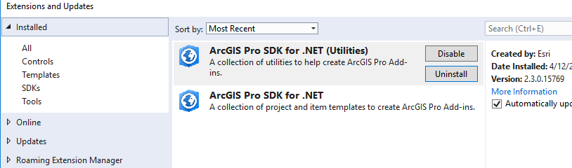

I went through the steps of installing the ArcGIS Pro SDK in Visual Studio 2017 Community.  When I got to the step to verify the installation, by starting a New Project, there is no listing of the templates, even though I see they are installed under Tools - Extensions and Updates.

In your Visual Studio Community Edition installation, can you please check if you have installed the .NET Desktop development workload?  This is required to display the templates.

Thanks.  That did it
