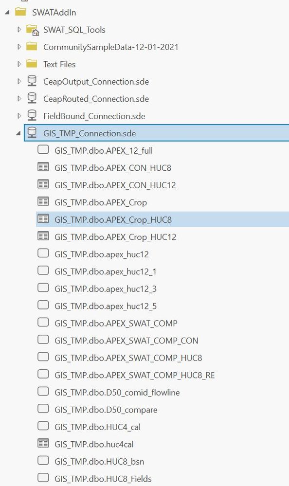

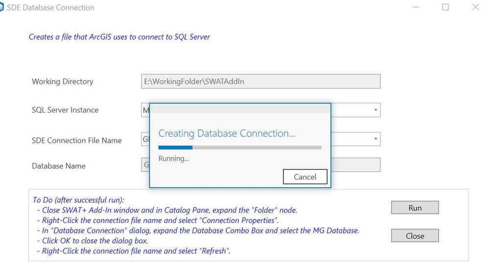

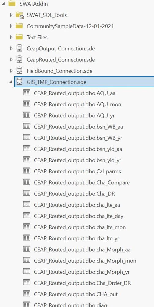

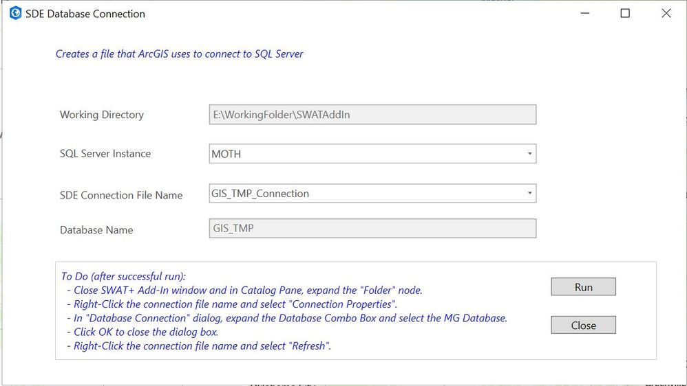

Hi,
Please the attached images.  As you can see, in my Add-In:
1. Users select the allowed database connection they can create.
2. Then they click the "Run" button.
3.  The SDE Connection is created in the working folder.  But if you expand the name, you'd see the tables are not the tables for the selected database.

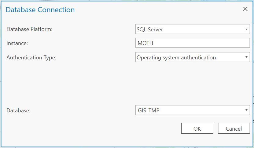

4. As a workaround, I make the user click "Connection Properties" (image 4) and reselect the database.
5.  Then back at the Catalog pane, they click "Refresh" to show the actual tables for that database.
Why doesn't it just show the actual tables connected with the database?  The workaround is so cumbersome and some users may not follow the instructions I provided in the GUI.  Who wants to read those?
KimberlyGarbade
Hmmm... so no matter what the user chooses (like if  they type or choose "GIS_TMP") they are initially connected to the "CEAP_Routed_Output" database instead...
Here is a post that addresses a similar situation.
https://community.esri.com/t5/python-questions/python-script-using-arcpy-createdatabaseconnection/td...
I think it is saying that you have to fully quality the inputs your putting in your MakeValueArray.  For example rather than populating the array with SQL_SERVER you would use database_platform="SQL_SERVER".  I think the post is suggesting that since the optional inputs into the CreateDatabaseConnection_management function are being left blank, python needs the fully qualified inputs to know which array values are used to populate which parameters of the function.  Sounds just crazy enough to work.
The only other thing I can think of is that when your using the function from the app it isn't overwriting a current connection file having the same name as the one you are creating; and that existing file is pointed at "CEAP_Routed_Output".  You might try setting overwriteoutput to true in your script or deleting any existing connection file with the same name in the same folder before creating the new one.
