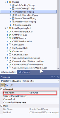

Make sure your image has the 'Build Action' set to 'Resource':
and declare the image in the config.daml as shown (make sure to replace the <your_DLL_Name> with the name of your add-in):
 <button id="TaxParcelPlenary_DisasterFlood" caption="Flood Disaster" className="DisasterFlood" keytip="B3"
                loadOnClick="true"
                largeImage="pack://application:,,,/<your_DLL_Name>;component/Images/DisasterFlood32.png">
          <tooltip heading="Flood Disaster">
            Adjust the Tax Assessment after a declared Flood Disaster<disabledText />
          </tooltip>
 </button>
