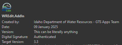

I've successfully placed build numbers there in Pro v3.3. Experimenting a bit more, I found that the "version" attribute of the "AddInInfo" node in Config.daml can be anything. Here's a screen grab of my working addin in Pro's "Add-In Manager" screen to illustrate . . .
