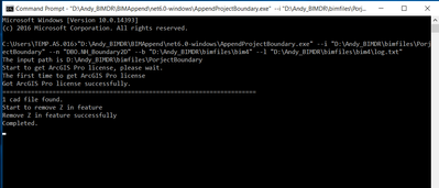

 The program will not exit normally like below screenshot:

GKmieliauskas
Hi,
Depending on your screenshots issue is outside code you have added. There is no code with Console.WriteLine("Finished"); or Console.WriteLine("Completed");
gaofangwan
Yes, I do not paste all code here. I have attached the vs project file.
GKmieliauskas
I have tested your solution. One thing I have changed was path to dwg and dwg file name. It finished with code 0.

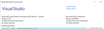

Could you tell me which Visual studio and SDK version you use?
My Visual studio 2022: 17.6.1
ArcGIS.CoreHost.dll: 13.1.0.41833
ArcGIS.Core.dll: 13.1.0.41833
GKmieliauskas
VS: Version 17.4.3
Check which ArcGIS Pro extensions for Visual Studio you use.
I use 3.1.0.48133
